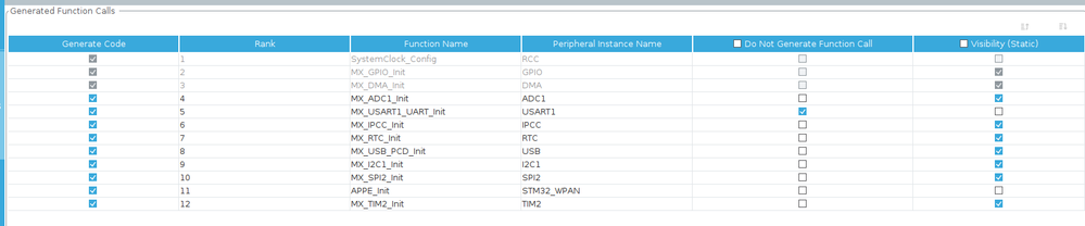

} Setting up the debugging for WPAN has been done to setup guide:
MX_USART1_UART_Init() isn't called in the main() function but called in the DbgOutputInit() function:
