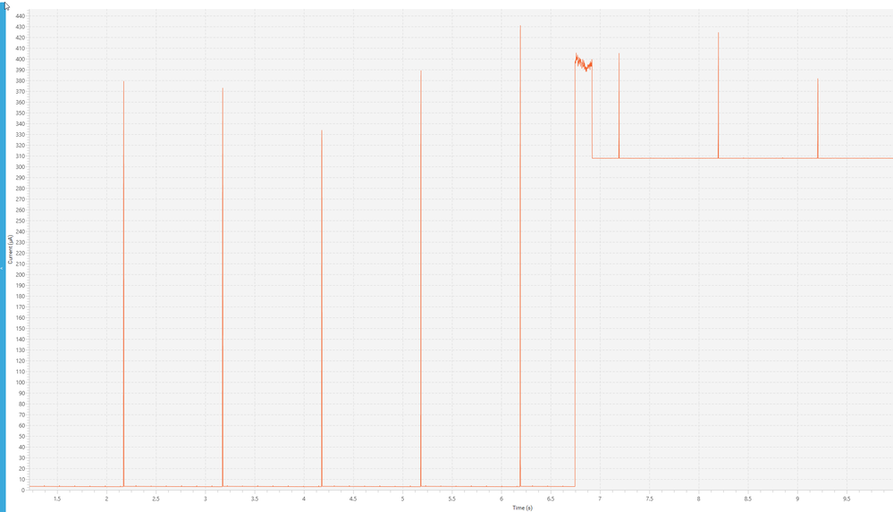

2024-06-27 5:23 AM
There shouldn't be any issue in this regard.
I'd suggest starting from one of the BLE examples. E.g. here I'm using the BLE_Beacon project. By default, the user buttons are set so that I can wake up the MCU and I added a simple code to switch between STOP and SLEEP modes. This is the resulting power consumption.

2024-08-15 1:29 AM
You can insert the following code e.g. into the APP_BLE_Key_Button3_Action in app_ble.c:
if (UTIL_LPM_GetMode() == UTIL_LPM_STOPMODE) UTIL_LPM_SetStopMode(1 << CFG_LPM_APP, UTIL_LPM_DISABLE);
else UTIL_LPM_SetStopMode(1 << CFG_LPM_APP, UTIL_LPM_ENABLE);
