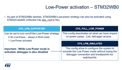

See more details in below slide :
This settings should allow you to reach lowest low pwer mode whith RF active ( the STM32WB09 will enter low power mode between 2 BLE events - of course RAM and Low speed clock are maintained during this period - everything else is switched off)
