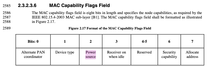

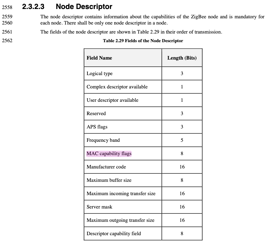

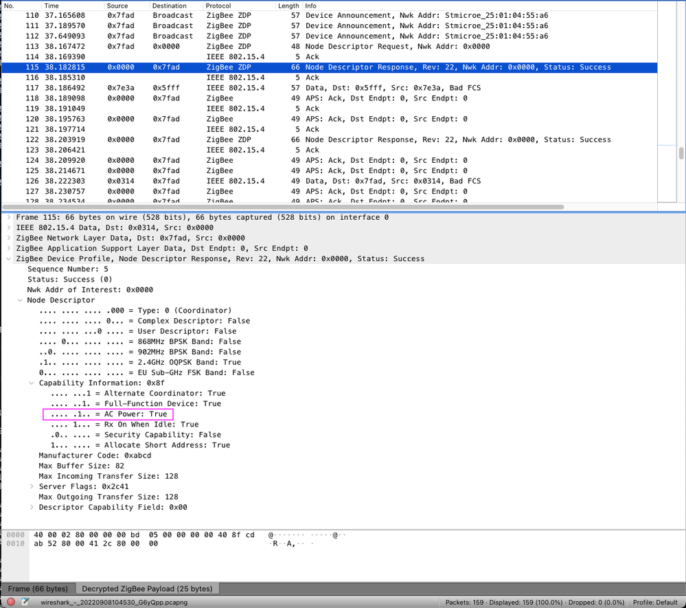

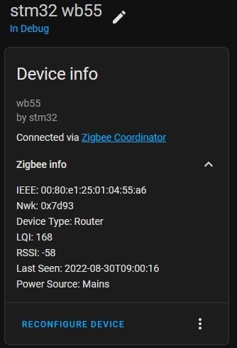

Even after changing the Basic cluster Power Source attribute, the issue in Home Assistant still remains; the Node Descriptor is still reporting that the device is mains powered.
Is it possible to edit the Power Source bit in the Node Descriptor MAC Capabilitiy Flag per the table from the zigbee standard? Thanks

earlish
Associate II
If anyone else come across this thread and is interested, I was able to change the node descriptor with the following line of code:
config.capability &= ~(MCP_ASSOC_CAP_PWR_SRC);
I added it to the APP_ZIGBEE_NwkForm() function, so now my startup code looks like this:
