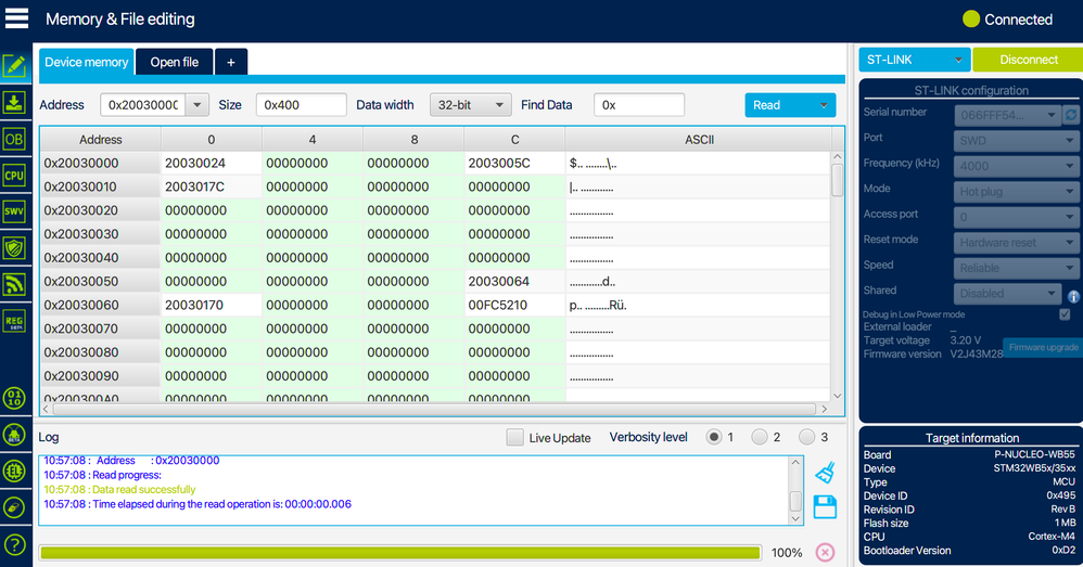

Hi.
I have nucleo board with STM32WB55RGV6 mcu. Trying to start FUS using StCubeProgrammer (swd mode), and unable to start it and even get its version. I do what is described in wiki: connect in normal mode + hardware reset, start fus, disconnect, start in hotplug mode. Tryed many combination but nothing works. What can be the reason?Screenshot 2023-09-20 at 10.57.30.png
                        STM32CubeProgrammer v2.14.0
ST-LINK SN  : 066FFF545057717867055039
ST-LINK FW  : V2J43M28
Board       : P-NUCLEO-WB55
Voltage     : 3.21V
SWD freq    : 4000 KHz
Connect mode: Normal
Reset mode  : Software reset
Device ID   : 0x495
Revision ID : Rev B
Device name : STM32WB5x/35xx
Flash size  : 1 MBytes
Device type : MCU
Device CPU  : Cortex-M4
BL Version  : 0xD2
Debug in Low Power mode enabled
UPLOADING OPTION BYTES DATA ...
  Bank          : 0x00
  Address       : 0x58004020
[==================================================] 100%
  Bank          : 0x01
  Address       : 0x58004080
OPTION BYTES BANK: 0
   Read Out Protection:
     RDP          : 0xAA (Level 0, no protection)
   BOR Level:
     BOR_LEV      : 0x0 (BOR Level 0 reset level threshold is around 1.7 V)
   User Configuration:
     nBOOT0       : 0x1 (nBOOT0=1 Boot from main Flash)
     nBOOT1       : 0x1 (Boot from code area if BOOT0=0 otherwise system Flash)
     nSWBOOT0     : 0x0 (BOOT0 taken from the option bit nBOOT0)
     SRAM2RST     : 0x0 (SRAM2 erased when a system reset occurs)
     SRAM2PE      : 0x1 (SRAM2 parity check disable)
     nRST_STOP    : 0x1 (No reset generated when entering the Stop mode)
     nRST_STDBY   : 0x1 (No reset generated when entering the Standby mode)
     nRSTSHDW     : 0x1 (No reset generated when entering the Shutdown mode)
     WWDGSW       : 0x1 (Software window watchdog)
     IWDGSTDBY    : 0x1 (Independent watchdog counter running in Standby mode)
     IWDGSTOP     : 0x1 (Independent watchdog counter running in Stop mode)
     IWDGSW       : 0x1 (Software independent watchdog)
     IPCCDBA      : 0x0  (0x0)
   Security Configuration Option bytes - 1:
     ESE          : 0x0 (Security disabled)
   PCROP Protection:
     PCROP1A_STRT : 0x1FF  (0x80FF800)
     PCROP1A_END  : 0x0  (0x8000800)
     PCROP_RDP    : 0x1 (PCROP zone is erased when RDP is decreased)
     PCROP1B_STRT : 0x1FF  (0x80FF800)
     PCROP1B_END  : 0x0  (0x8000800)
   Write Protection:
     WRP1A_STRT   : 0xFF  (0x80FF000)
     WRP1A_END    : 0x0  (0x8000000)
     WRP1B_STRT   : 0xFF  (0x80FF000)
     WRP1B_END    : 0x0  (0x8000000)
OPTION BYTES BANK: 1
   Security Configuration Option bytes - 2:
     SFSA         : 0xD4  (0x80D4000)
     FSD          : 0x1 (System and Flash non-secure)
     DDS          : 0x1 (CPU2 debug access disabled)
     C2OPT        : 0x1 (SBRV will address Flash)
     NBRSD        : 0x1 (SRAM2b is non-secure)
     SNBRSA       : 0x14  (0x2003D000)
     BRSD         : 0x1 (SRAM2a is non-secure)
     SBRSA        : 0xA  (0x20032800)
     SBRV         : 0x35000  (0x20000000)

gprgprgpr
Associate
All those tutorials show "happy path" when everything works, I wouldn't have asked the question in that case. I tried all combination with dfu, uart, and I suspect bootloader might be damaged somehow, I can connect to board only using st-link.
This board is from ebay and I suspect it might be damaged. Just wanted to ensure I'm not missing something obvious before returning it.
detakm
Associate II
From what I can see your device's ESE, FSD, NBRSD and BRSD option bytes look incorrect. I am not certain how your device ended up in that situation but a common cause (from what I've learned) is disrupting power to the device when FUS is working with flash or writing option bytes.
