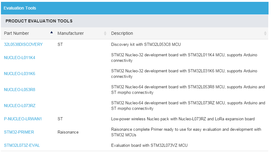

There is no STM32L072_Discovery available, that is why you don't see it in MX. Here the list of L0 boards:
But you still able to use the PCC (Power Consumption Calculator) features: you have to select the STM32L072 device then configure the peripherals you need to use in your board. The calculator will provide estimations based on your configuration and the values provided in your product datasheet.
-Amel
Edit: it seems you are using theB-L072Z-LRWAN1, right? This one isn't yet supported in MX. I will check if this will be done and when?
My proposal to use PCC based on device selection remains valid
