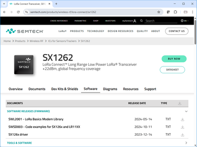

Semtech provide hardware-independent software on their Product Page:
https://www.semtech.com/products/wireless-rf/lora-connect/sx1262

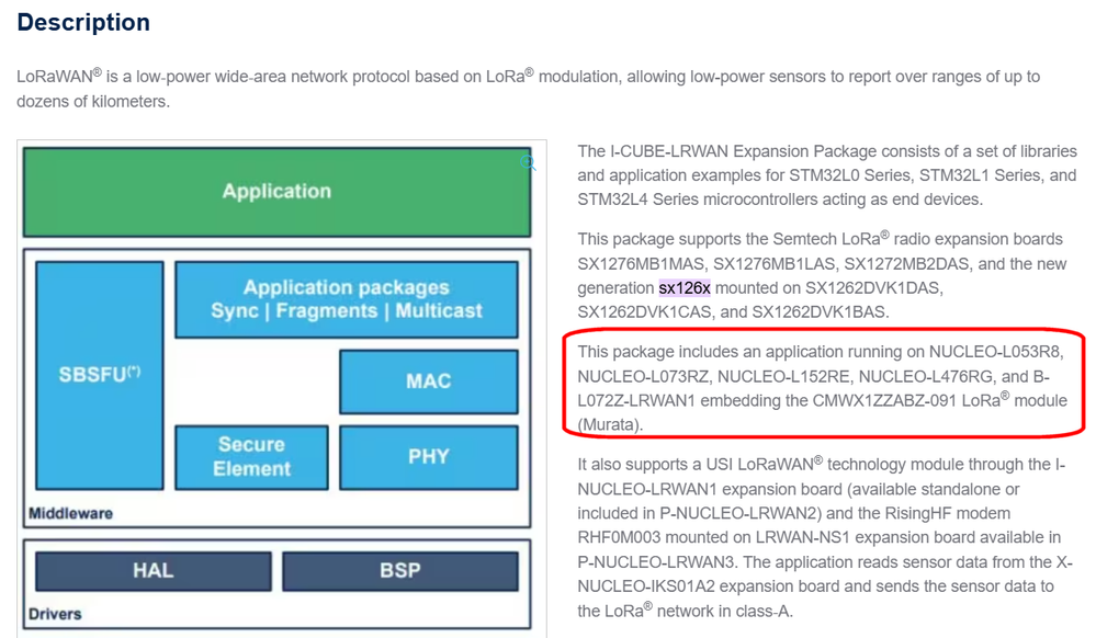

Having said all that, ST's I-CUBE-LRWAN provides specific support for STM32.

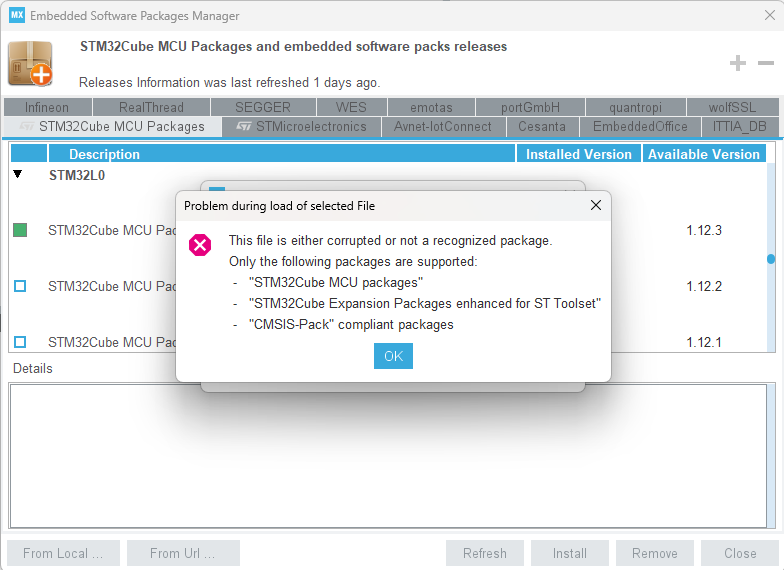

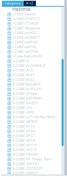

My MCU has 32kB of flash (STM32L031F6P6), and I managed to get a package with at least 46KB using the BasicMAC library.
I'm having trouble adding I-CUBE-LRWAN; it doesn't appear in the options:
I tried manually adding the .zip file, but got the following error:
Does I-CUBE-LRWAN support STM32L031 family microcontrollers?
Probably, it supports others in the L0x range, I've seen L07x
I do however anticipate it creating something too big, and a build for the L07x should illustrate this quickly enough. Those parts have 192KB of FLASH in the Murata parts, it doesn't use all that, but I'd suspect a LoRaWAN build with any Hash or Crypto would get a foot-print larger than 32KB

@robertcabral wrote:I'm having trouble adding I-CUBE-LRWAN; it doesn't appear in the options:.
It isn't actually a Package like that - it's just a bunch of source files.
You just unzip them.
@robertcabral wrote:Does I-CUBE-LRWAN support STM32L031 family microcontrollers?
It doesn't provide a ready-to-go project - but porting from one of those listed shouldn't be hard.
As @Tesla DeLorean says, try building one of them and see if that'll fit ...
