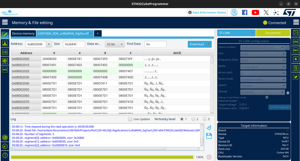

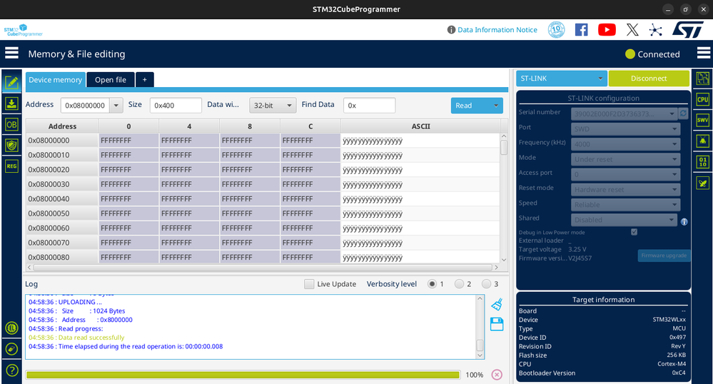

i try to program LSM100A ( STM32WLE5CC ) .
i can connect but can't program an elf file : error fail to erase memory, then cube programmer crashed.
thank you for support

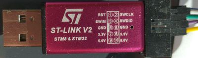

It semes that you are using a clone ST-LINK V2, so we can’t guarantee that it will work fine. Please ensure that you are using a genuine ST-LINK V2 to guarantee that it will work fine. More details are available in this article.

dam74
Associate II
I'm using V2.18.0.
Here's the STlink I'm using with STM32F103 also.
Best Regards.
STTwo-32
thank you for your reply.
i test with a stlink v3 minie, it's all fine !
