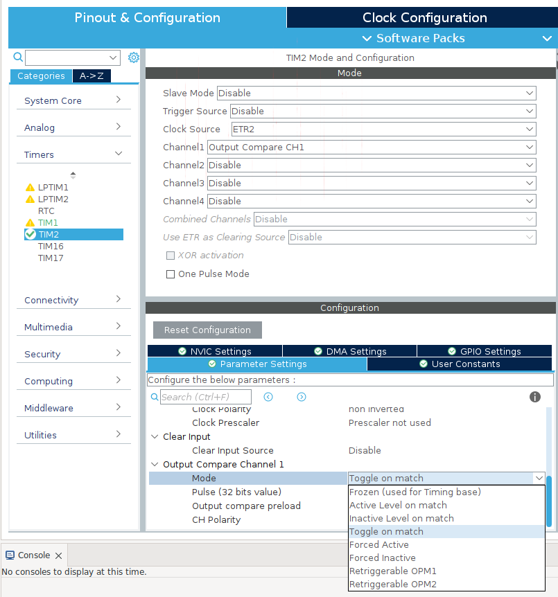

I have a board Nucleo WB55 and I'm configuring PWM on channel 1 of TIM2.
I know is possible configure PWM Mode 1 also on channels configured as Output Compare, but CubeIDE not allow set this configuration, I think is an issue.
I changed the init code with TIM_OC_MODE_PWM1 and works.

Hi @juvann ,
Thank you for your contributions and for your detailed explanations,
I confirm the issue on my side, it has been reported to STM32CubeMX development team .
Internal ticket number: 144724 (This is an internal tracking number and is not accessible or usable by customers).
I will keep you posted with updates.
Hope this answered your question.

PWM1 is simply a variant/superset of Compare mode; software-wise it is simply compare mode, it just controls the hardware output differently. You may configure PWM mode and keep the output disabled - then there is no difference between these two modes.
