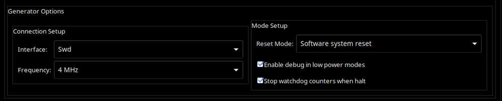

My debugger settings are like this:
Please give me solution for this error
