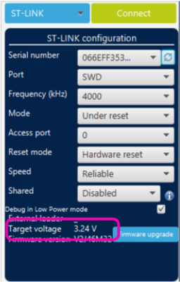

can you verify the target voltage detected using cube programmer?
Also did you try to connect to it after putting it in BOOT0 ?
BR
