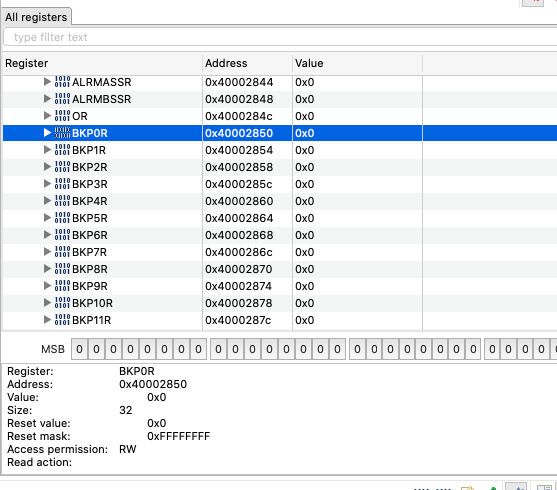

We're faced to an issue in the RTC module. RTC registers: time, date and backup register aren't saved after power off ( we measured the VBAT supply is about 3v given by the supercapa), we used a magic number to ensure that data aren't reinitialized at each software startup:

2025-07-22 8:05 AM
Hello @freecoder,
This is probably a hardware issue...
If VBAT drops below 1.55V, the backup domain won't function correctly, so the RTC register content will be lost; are you sure the Vbat level is stable? can you share how VDDA/VREF+ is exactly connected?
