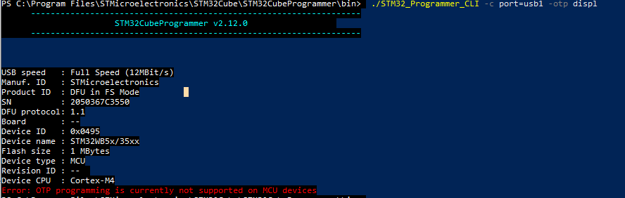

I connected my STM32WB5M DK with USB DFU mode according to manual and description.
When i want to read or write the opt area over the cli and i got the error:
Error: OTP programming is currently not supported on MCU devices
What does it mean it is currently not supported? I saw in other post it was working in other versions?

try out openocd, i have it running in raspberrys and linux PCs
