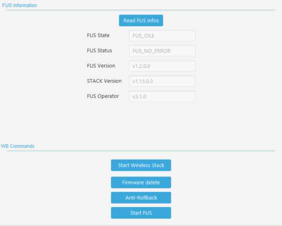

My FUS infos are :

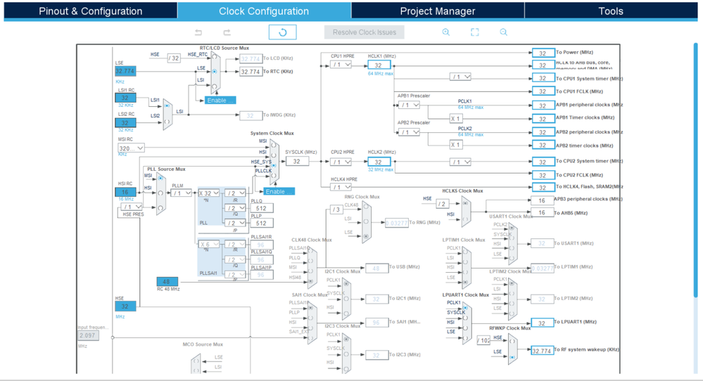

And my clock tree:

2023-02-22 7:39 AM
I found out that no BLE Stack was running on CPU2 (Cotex-M0+).
I solve this issue by:
Step1: updating the BLE STACK to the last version (STM32Cube_FW_WB_V1.15.0\Projects\STM32WB_Copro_Wireless_Binaries\STM32WB5x\stm32wb5x_BLE_Stack_full_fw.bin) at the corresponding address (check the release note according top your exact STM32WB55xx).
Step2: Start the Wireless Stack (I use STM32CubProgrammer to achieve this).
After that everything's work flawless.
Hope this will help,
Regards,
Axel.
Note: AN5185 was very usefull (https://www.st.com/resource/en/application_note/dm00513965-st-firmware-upgrade-services-for-stm32wb-series-stmicroelectronics.pdf)
