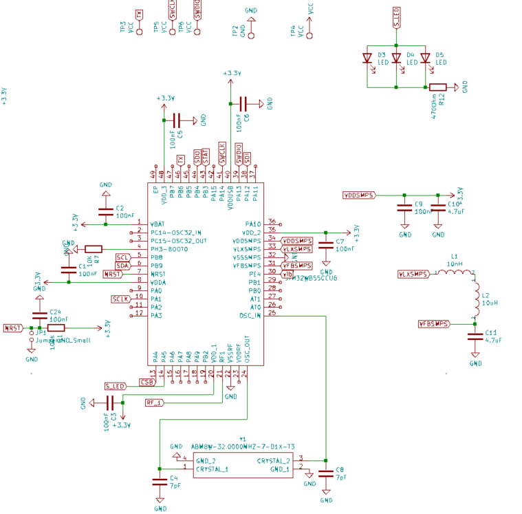

I'm working with a custom STM32WB55CCU6 board I've created. I made it to where the only interface is the SWD PA14/PA13.
I'm 99% sure my schematic is fine as I used the STM32WB design guidelines and sample schematics as my reference. (BOOT0 - Tied to ground with 10K resistor, NRST tied to 3.3V with 100K resistor and 100nF cap in between).
I'm using a 32MHz crystal.
Here is my schematic.
I'm using a generic STM-LINK/V2 with firmware version V2J37S7.
I'm connecting 3.3V, GND, SWCLK, SWDIO, and NRST to the STM-LINK.

Most issues are caused by Connectivity or Power, an un-powered scan chain isn't going to function. Check state of NRST pin, check power supply, look at with scope.
Code on device using LOW POWER or STANDBY type modes?
Should VDDRF be powered?

I have a feeling the issue is VDDRF... Looks like that powers the HSE which the STM32WB is reliant upon... It's weird because my oscilloscope is showing the SDWDIO interface working without the ST-Link connected.

Update: I ran a jumper from 3.3V to VDDRF. Still not working. Double checked on my oscilloscope and SWDIO is definitely outputting signal
