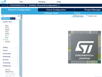

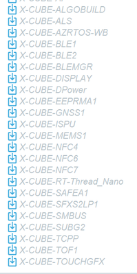

2024-08-15 11:01 AM
Hi there, I do not see an option to enable touch sensing for this MCU. It does appear to automatically be there for the
STM32F072RB MCU though.
Is there something I need to configure in order to get it to appear?
2024-08-15 11:27 AM
It should be under middleware. It may be garyed. If so, please put you cursor on it and a message that tell you what you have to do before you can enable it.
Dont forget to use the last version of CubeMX (V6.12.0).
Best Regards.
STTwo-32
2024-08-15 12:02 PM
I cannot seem to find a grayed on TSL library
2024-08-15 12:37 PM
never mind, the STM32WB55CE does not have touch sensing capabilities.
2024-08-15 12:42 PM
After checking, your MCU does not support the touch sensing capability.
You need to use another one.
Best Regards.
STTwo-32
