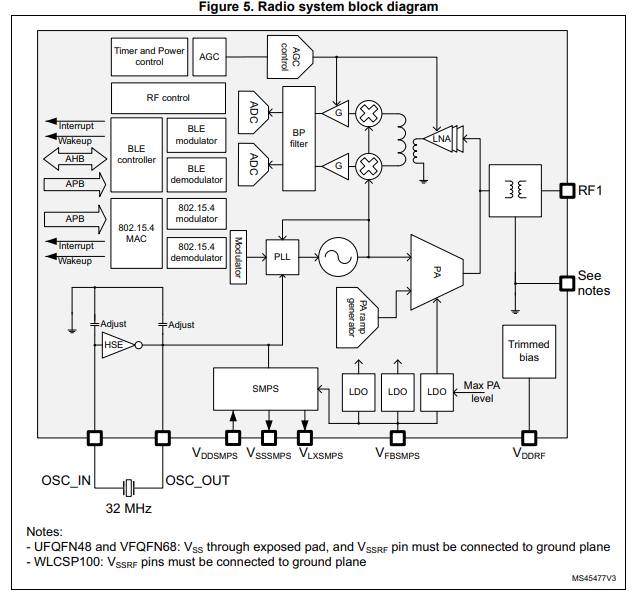

The datasheet for STM32WB55RG (DS11929, 3.6.1 RF front-end block diagram, page 22) states that the output power is user programmable:
"In Transmit mode, the maximum output power is user selectable through the programmable LDO voltage of the power amplifier. A linearized, smoothed analog control offers clean power ramp-up."
The figure 5 in reference manual RM0434 shows a Max PA level input to the LDO but I can't find the register to set this value.
How do I program the RF transmit power on a STM32WB55 ?
Thanks for considering my request.
