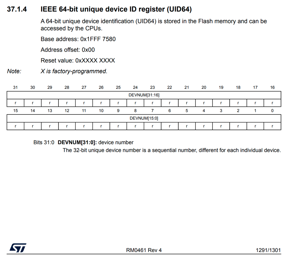

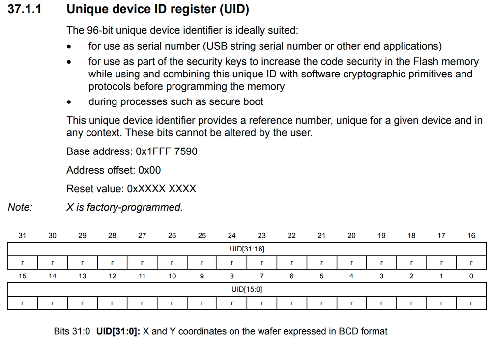

I'm working on the two MCU's STM32WLE5C8U6 & STM32WLE4CCU6 and I need to know the UID in order to indentify each of the products.
In the doc it's written that both have UID but there is no address to read them.
What I'm missing ?

Locations for both the regular 96-bit UID and the UID64 are found in the reference manual.

Thank you for the reply, that's what I need.
