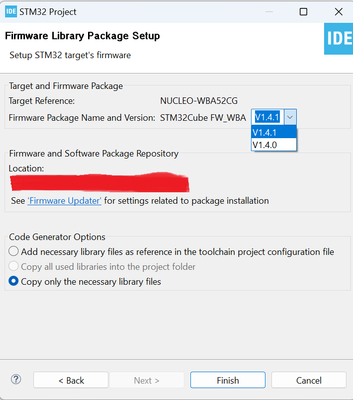

ok, but in the newest CubeIDE I can only select FW 1.4.0 or 1.4.1.
Sorry for this mistake. you have to use an older version of the IDE/MX
