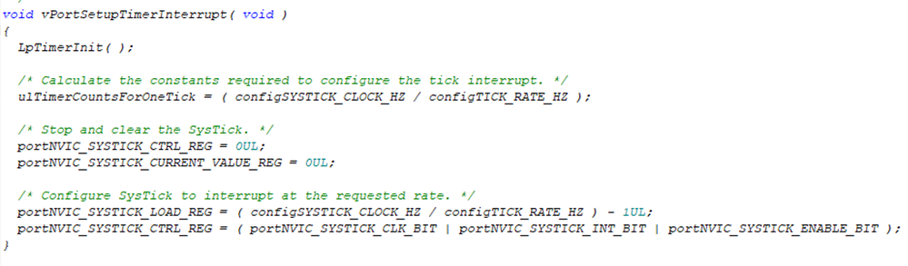

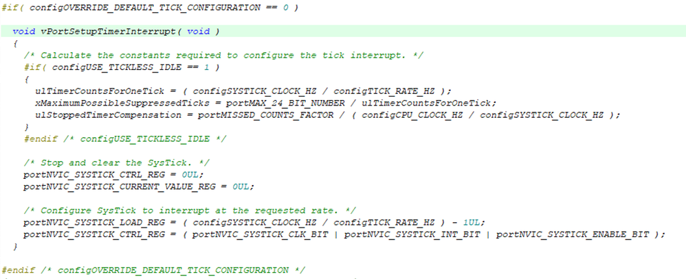

when I open this files I see that there are two implementations
im freertos file
and this is port file
They are not declared globaly. When I comment one of them, I get two new errors, when I seattle these new errors, I get news one. How to end up with this?
