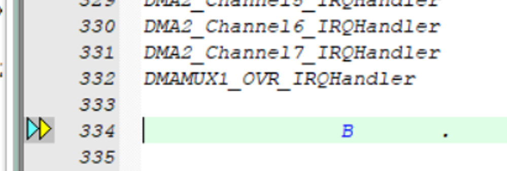

Hello! I am using PWM to generate 1.25 ms period pulse to trigger a LED strip light . In main.c , properly in while(1) when I called HAL_TIM_PWM_Start_DMA followed by HAL_Delay the program got stuck in uint32_t tickstart = HAL_GetTick(); . When I runned the debug once again it now gets stuck in the place shown in the image (in the file startup_stm32wb55xx_cm4 )
How could I solve this?

Your debugging issue is a separate problem. "B ." will jump to the current address. Queue infinite loop. Probably shouldn't be making it to that statement. Issue a reset to get it to go back to Reset_Handler. Maybe your main() function is illegally returning. Hard to know without seeing any code.

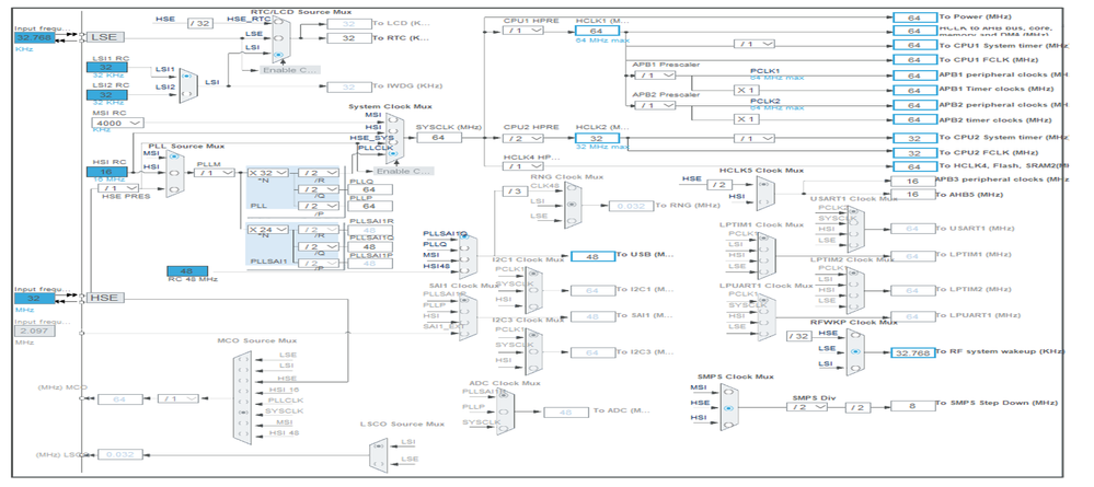

even this code works weirdly. It sometimes works (when I randomly start or stop the debug) but often doesn't. I will show the clock configuration, may be something is not ok there

It is in the Default_Handler, with hundreds of other IRQHandlers, because you don't have an IRQHandler defined for an interrupt you're using.
Review the Linker's .MAP file to confirm what and what is not bound properly.
Watch for one or more WEAK definition of the same handler.
