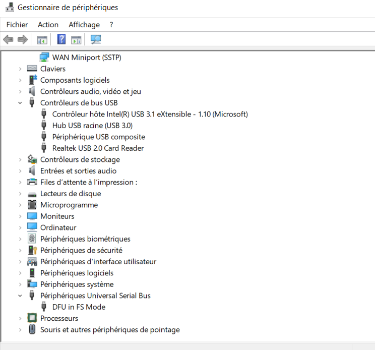

I developed a PCB for a project using STM32WB55 and after getting it manufactured I am trying to connect it to the computer in order to run the code on it.
However, when I connect it to the PC I cannot see the COM port for it. It seemly doesn't detect the COM port. All I can see is the DFU in FS Mode under Universal Serial Bus which I am not that sure what it is or how to make use of it. ( see picture below. Sorry for it being in French)
I want to run the code on the PCB by using the bootloader, however in order to do that in to use the STM tools, I need to see the COM port.
What do you think I should do?
2020-06-18 5:45 AM
It looks like the chip is in bootloader mode. You can flash the chip with ST-Link or STM32CubeProgrammer to put your code on there. Make sure BOOT0 is low when the chip resets to run your own code.
