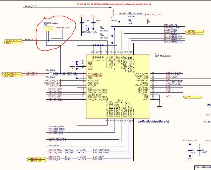

We are currently developing LoRaWAN's end device.
Before connecting JP9 1-2 to control TCXO,
I tried to check if the output is coming from PA12, but only the voltage of mV is detected.
No matter how much you look at the circuit diagram, the only connection to PA12 is SB13 that is disconnected from JP12(PIN1).
I gave all the settings of GPIO to HIGH, but I checked that all except PA12, PA11 PB13.
I'd appreciate it if you could tell me what I did wrong!
Below is the code.

2021-06-15 9:45 PM
I solved it.
I'm writing it down just in case there's someone like me who's doing it.
Please connect JP2.
If you leave the jumper open, PA12 seems to be bitten by GND.
