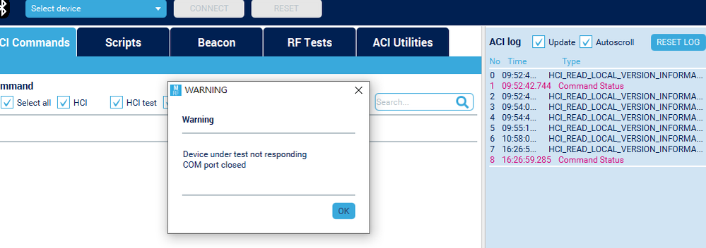

I connect JP5 DEBUG pins of Nucleo Board to CN1 DEBUG pins of USB Dongle, then use STM32cubePorg tools to Update Firmware.
When I use the example firmware: ble_transparent_mode_vcp, and connect USB Dongle on STM32CubeMoniter-RF.
It show a waring message : "Device Under the test no responing COM port closed"

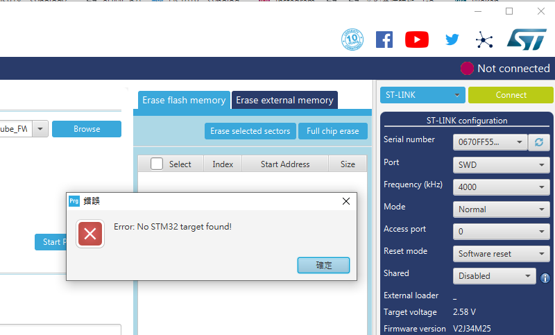

When I update back to demo example: BLE_p2pClient.
Then STM32cubePorg show a error message :"NO STM32 target found"
May I ask how to fix those problem?
Thanks.
