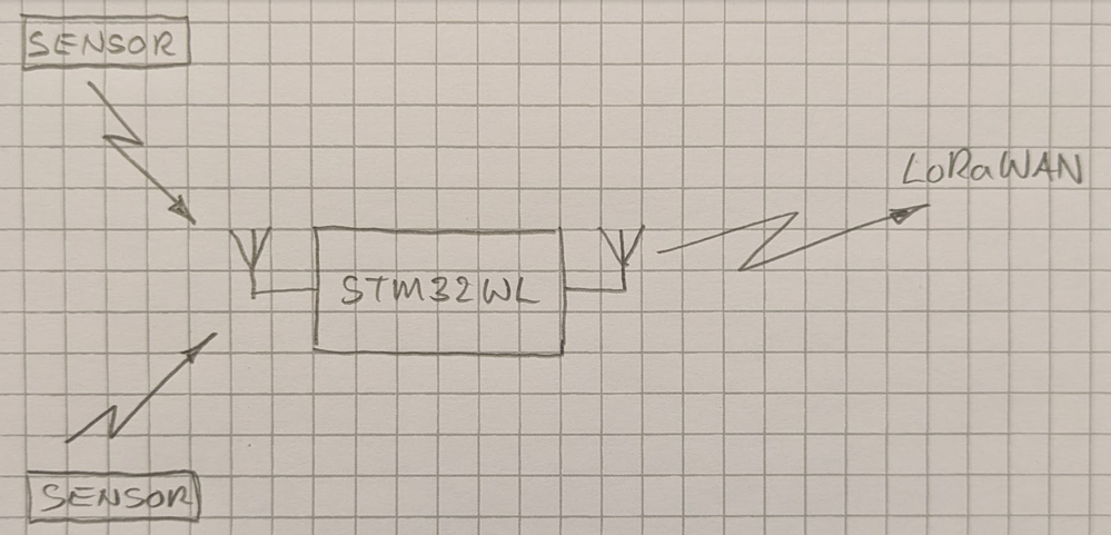

2025-06-03 7:52 AM
@Andrew Neil wrote:Just like your mobile phone needs to be within range of a cell tower,
Taking that analogy a bit further:
Can we think of your STM32WL as the "phone", which connects to the cell tower?
So the phone has some sensors in it, and can send their data to The Network
Then your additional sensors could connect to the phone - eg, via Bluetooth - and the phone can also send this data to The Network.
Is that the kind of thing you're thinking of?

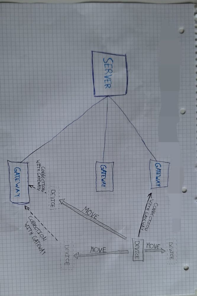

2025-06-04 12:48 AM
Yes, by “near” I meant “close enough for a connection to be established”. Thanks for clarifying with the phone analogy, I had understood myself, but I hadn't found the right words in my explanation.
Here's an explanatory diagram. I want to do some tracking. We have a single device that can move around and every so many times it communicates with the server (via the gateway(s) with which it's able to establish a connection).
If the device manages to establish a connection with 2 gateways, they must not send data at the same time to avoid collisions. What's more, when the server receives this data, it must be able to see that it's the same data, and so respond to only one gateway, for example.
I hope that's clearer now !!
2025-06-04 12:59 AM - edited 2025-06-04 1:09 AM
Sorry, is this a new question?
I'm afraid I don't see how any of this relates to the preceding discussion.
@KYZ wrote:If the device manages to establish a connection with 2 gateways, they must not send data at the same time to avoid collisions.
This is inherent in the design of LoRaWAN:
