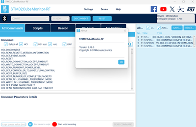

I've personally tested this by uploading the BLE_TransparentMode_reference.bin from the STM32CubeWBA V1.7.0 and using the STM32CubeProgrammer V2.20.0. After that, i've been able to connect it to the STM32cubeMonito-RF V2.18.0 without an issue:
I think you should update the CubeMonitor-RF to the newest version (since it may be an issue on the oldest versions).
