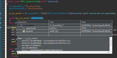

2025-03-17 3:10 AM
Thank you for reaching out :smiling_face_with_smiling_eyes: I took a screenshot of the values it shows
2025-03-17 4:15 AM
The event code seems okay. Can you please step further?

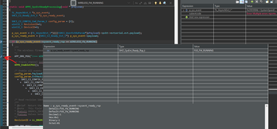

2025-03-17 5:06 AM - edited 2025-03-17 5:07 AM
It seems not to enter the "wireless firmware running" block but instead this
else if (p_sys_ready_event->sysevt_ready_rsp == FUS_FW_RUNNING)
* The FUS firmware is running on the CPU2
* In the scope of this application, there should be no case when we get here
APP_DBG_MSG(">>== SHCI_SUB_EVT_CODE_READY - FUS_FW_RUNNING \n\r");
/* The packet shall not be released as this is not supported by the FUS */
((tSHCI_UserEvtRxParam*)pPayload)->status = SHCI_TL_UserEventFlow_Disable;
Red arrow points that the second breakpoint is not reached
2025-03-17 5:24 AM
Thank you, currently the MCU is running FUS.
STM32WB Firmware Upgrade Service - stm32mcu
Please connect the board to STM32CubeProgrammer, click on "Start Wireless Stack" button and flash the application again. It should fix the issue.
Best regards,
FK
2025-03-17 5:49 AM
Thank you a lot! Somehow I have missed this step but it seemed to fix and now I'm able to continue!
