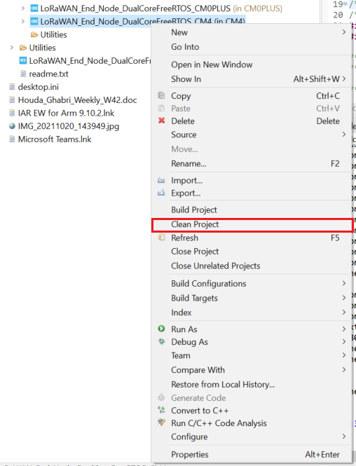

Hi @LLr.1 ,
In order to solve this issue, you just need to clean the project and then rebuild it. Please refer to the attachment.

2021-11-30 5:43 AM
Unfortunately, this also appears right after the clean.
Maybe the reason, it is git in my files ?
Louis
2021-11-30 5:46 AM
The bad solution I found, it's to add the cited file in the cited path of folders
