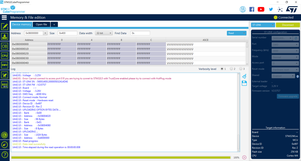

The command line shows that this board requires a software reset. I changed the reset mode to the hardware reset and shared it to enable, pressed, and hold the button Reset on the board, and I clicked on the Connect button in the STM32Cube Programmer IDE and...
Every source on the Internet mentions that the reset button should be held until clicking on the Connect button. So I click on the reset button and release it, and next click on the Connect button, and viola...
I think a little bit closer to my target now.
2023-01-22 5:58 AM
It's the final cut and the end of the story (but I have to change Read Protection Level to AA - no protection):
My WIO-5 board is ready for programming now (I hope :) )
