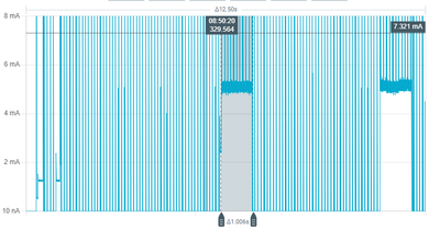

Now this also means that each advertising event of the radio module, generates an interrupt that will wake up the MCU and the sequencer will check again if there is somehthing to be done. If nothing is pending, it will go back to a low power mode. For example in the image below each spike of current is when an advertising event happend and the MCU had to wake up. During those 1s time is when the MCU was doing something an could go to a low power mode.

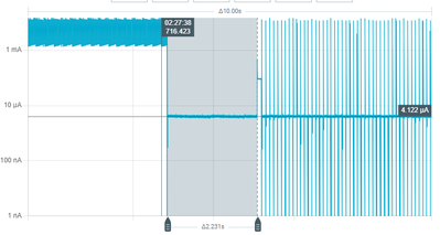

if you really want to stay in a low power mode for a prolonged time and only be woken up by a switch, then you need to disable the advertising. Like in the example below:
