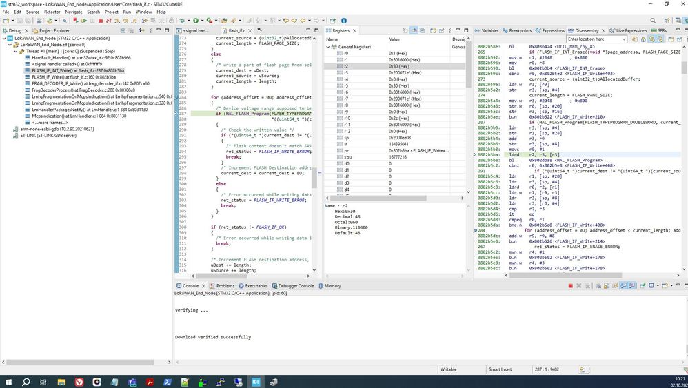

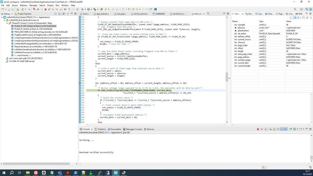

Code starts with no issues, connecting to AWS IoT Core, joining multicast group. Problem happened when FUOTA starts and first packet is receiver. Device gets into hard fault, there is "unaligned memory error", when 48-bytes of firmware is coppied to flash memory using LDRD command. It happens because source address is 0x200071EF which is not 8-byte aligned. I fixed that with very simple coppying to another buffer. Now full firmware can be written to flash memory, but update process is still unsuccesfull, there are many flash_write errors and device reboots with an old firmware. I'm still trying to debug what's happening at the end, but maybe someone has tried to run FUOTA on stat uC and have some solution?
unaligned memory fix
Flash write error
LDRD unaligned memory

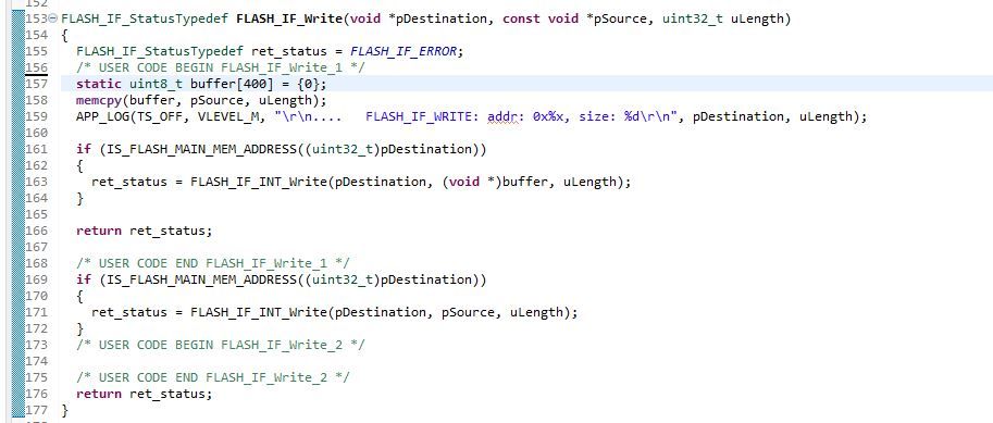

In LoRaWAN_End_Node/Core/Src/flash_if.c
line 156 added code
/* USER CODE BEGIN FLASH_IF_Write_1 */
memcpy(buffer, pSource, uLength);
//APP_LOG(TS_OFF, VLEVEL_M, "\r\n.... FLASH_IF_WRITE: addr: 0x%x, size: %d\r\n", pDestination, uLength);
if (IS_FLASH_MAIN_MEM_ADDRESS((uint32_t)pDestination))
ret_status = FLASH_IF_INT_Write(pDestination, (void *)buffer, uLength);
return ret_status;
/* USER CODE END FLASH_IF_Write_1 */
It fixes hard fault "unaligned memory error"
line ~256, changed from
if (FLASH_IF_INT_IsEmpty(pDestination, length) != FLASH_IF_MEM_EMPTY)
to
if (FLASH_IF_INT_IsEmpty(uDest, length) != FLASH_IF_MEM_EMPTY)
It fixes writing to flash across two pages, without that change checking if memory is empty was done in previous page, but next page was erased.
line ~280 after
if (FLASH_IF_INT_Erase((void *)page_address, FLASH_PAGE_SIZE) != FLASH_IF_OK)
I've added
if(HAL_FLASH_Unlock() != HAL_OK)
ret_status = -7;
break;
It is neccesary, because FLASH_IF_INT_Erase function is locking flash memory, but it has to be unlocked durning FLASH_IF_INT_Write.
Check that solution, it works on my custom board.

I;m using WL_V1.3.0. Your problem sounds like you have a hardfault related with "unaligned memory error". Check if that change in LoRaWAN_End_Node/Core/Src/flash_if.c wll help:
static uint8_t buffer[400];
FLASH_IF_StatusTypedef FLASH_IF_Write(void *pDestination, const void *pSource, uint32_t uLength)
FLASH_IF_StatusTypedef ret_status = FLASH_IF_ERROR;
return ret_status;
ret_status = FLASH_IF_INT_Write(pDestination, pSource, uLength);
/* USER CODE BEGIN FLASH_IF_Write_2 */
/* USER CODE END FLASH_IF_Write_2 */
return ret_status;
I didn't change FRAG_MAX_REDUNDANCY parameter, 10% is enough. FUOTA example takes a lot off FLASH memory, there is only a few kB left.
