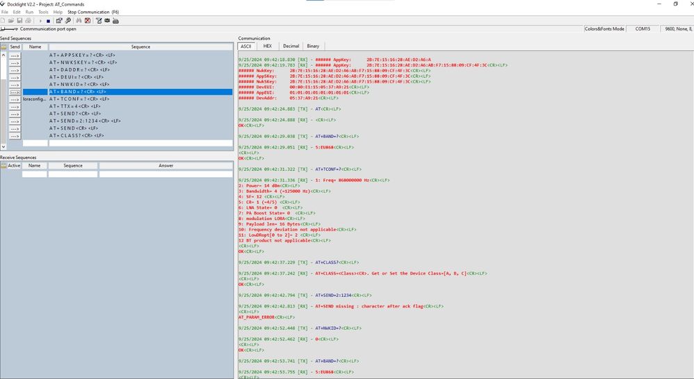

Hello Sir,
  We are using Example SubGHz_Phy_AT_Slave Replaced my User Board (stm32wle5 modules) AT commands works well.  But now i communicate P2P communication using AT commands two lora-e5 module is possible?.
If it is possible to communicate P2P Using AT Commands What are all the config we need to proceed. plz guide me to proceed further.
Thanks,
Hello @SYAMALA
Yes, you can create your own AT command to have a P2P communication throw AT commands. You just have to do a deep analyze of the AT command project that I've shared with you. After that, you can implement the send and receive command you want using the same method that are used to implement other commands. Finally, you can use your own AT Commands to have a P2P application.
Best Regards.
STTwo-32
