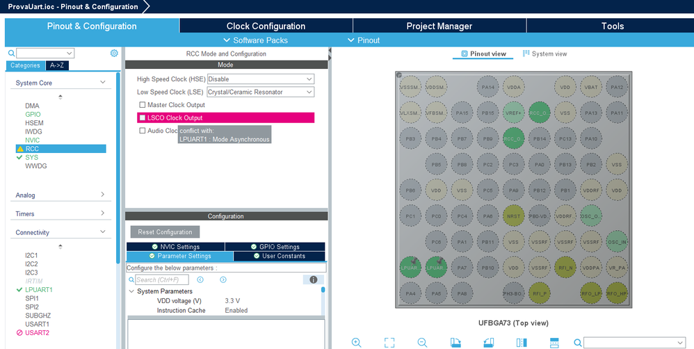

IOC file:
This is the warning I receive:
Screenshot 2024-10-10 111915.pngAdditional Information:
  • I receive a warning in the IOC file, which I have attached.
  • I have performed sanity checks, including verifying UART initialization and confirming that the hardware connections are correct.

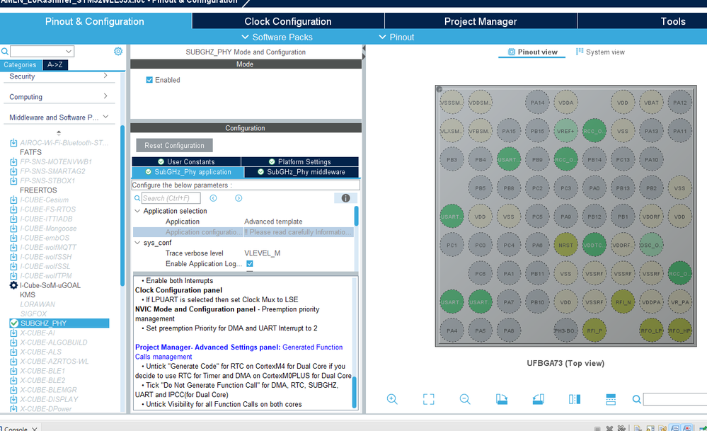

could this informations be helpful for my pourpouse?
"Application configuration recommendations
Parameter Description:
RCC: Proposed solution to manage RCC.
Modes: Low Speed Clock (LSE): Set value to Crystal Ceramic Resonator
Configuration - Parameters Settings:
   • Flash Latency(WS): 2 WS (3 CPU cycle)
   • Power Regulator Voltage Scale: Scale 1
Clock Configuration panel
   • Set MSI RC to 32MHz
   • Set RTC Clock Mux to LSE
RTC: Proposed solution to manage timer in Low Power mode.
   • For Dual Core operation Runtime Contexts are both Cortex-M4 and Cortex-M0+ and initializer is Cortex-M0+
Modes: Activate Clock Source, Activate Calendar and activate Alarm A (and B for Dual Core) (Internal Alarm A (and B for Dual Core))
User Constants: Add the following Constants
   • Constant Name: RTC_N_PREDIV_S Value: 10
   • Constant Name: RTC_PREDIV_S Value: ((1 << RTC_N_PREDIV_S)-1)
   • Constant Name: RTC_PREDIV_A Value: ((1 << (15-RTC_N_PREDIV_S))-1)
   • Asynchronous Predivider value: Set value to RTC_PREDIV_A
   • Bin Mode: Free running Binary mode
   • Alarm A Binary AutoControl: RTC_ALARMSUBSECONDBIN_AUTOCLR_NO
Configuration - NVIC settings:
   • Enable both Interrupts
USART/LPUART: Proposed solution to manage trace.
   • For Dual Core operation: Runtime Contexts is Cortex-M4
Modes: Asynchronous
   • If LPUART is selected then set Baud Rate: 9600 Bits/s
Configuration - DMA Settings:
   • Add USARTx_TX DMA Request with Channel configured with DMA1 Channel 5
   • If LPUART is selected then set Clock Mux to LSE
NVIC Mode and Configuration panel - Preemption priority management
   • Set preemption Priority for DMA and UART Interrupt to 2
Project Manager- Advanced Settings panel: Generated Function Calls management
   • Untick "Generate Code" for RTC on CortexM4 for Dual Core if you decide to use RTC for Timer and DMA on CortexM0PLUS for Dual Core
   • Tick "Do Not Generate Function Call" for DMA, RTC, SUBGHZ, UART and IPCC(for Dual Core)
   • Untick Visibility for all Function Calls on both cores"
I found them in the .ioc application file.
where i found it:
Best Regards.
