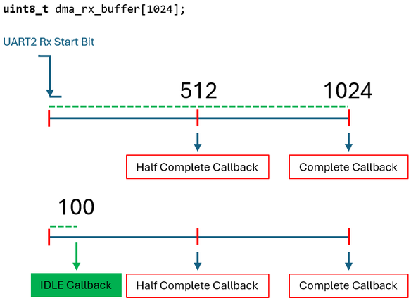

2025-05-20 6:44 AM
I tried different variants, but could not use the DMA in autonomous mode together with IDLE mode.
HAL_UART_Receive_DMA(&huart2, dma_rx_buffer, 1024); // start UART2 Rx DMA
__HAL_UART_ENABLE_IT(&huart2, UART_IT_IDLE); //enable IDLE InterruptAs shown in the graphic, I want to receive data of unknown length in the dma_rx_buffer. The buffer has a size of 1024 bytes and I start with HAL_UART_Receive_DMA.
After half of the data has been received, the CPU wakes up with a half complete callback. When 1024 bytes have been received, the complete callback is triggered and the DMA buffer is overwritten with the next byte at position [0]. If the data transfer is terminated after a total of 1124 bytes, the IDLE interrupt should be triggered here.
I start in UART Receive DMA mode and enable the IDLE interrupt, but the CPU hangs as soon i insert __HAL_UART_ENABLE_IT(&huart2, UART_IT_IDLE); function.
