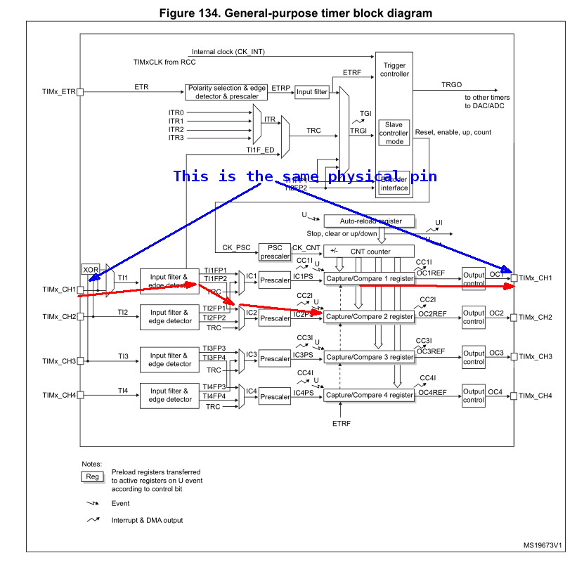

You can't. When pin is connected to TIM, it is in Alternate Function state set in GPIOx_MODER; whereas for GPIO output you'd need to set it to Out in MODER.
2020-01-10 4:58 AM
But maybe you can use a trick, using TIM's Compare as a means to output, and Capture on the adjacent channel.
2020-01-14 3:48 AM
Thank you, waclawek.jan, for the suggestion.
It worked!
