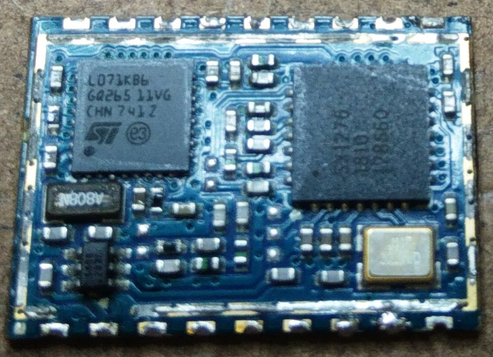

I used to examine the insides of rhf0m003 module several year ago, the chip inside was 071KB6 in QFN case. The chip is locked, and i think to level 2, cause when i tried to erase it with stlink, it turned to brick. You can only update the part of ROM using RisingHF bootloader. Its the part of product protection against copying.

By the way, when i started to develop my own lora devices, i used Rising 076 module with installed empty chip 071CBT6 on it, cause it's easier to solder TQFP case )) That way we get tested RF topology and empty chip. ready to use with CUBE LORA expansion set.
