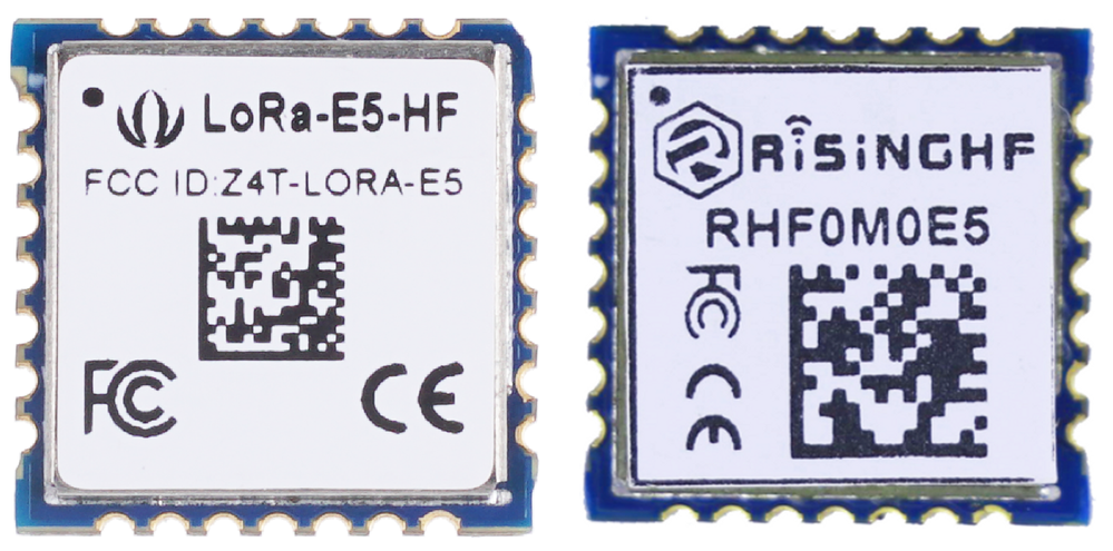

2021-03-18 2:00 AM
Seeed LORA-E5 is great, but there are only a limited number of STM32WL pins routed on the module.
2021-03-18 3:08 AM
You can try RisingHF WL module :
2021-03-18 4:44 AM
You mean this: https://www.seeedstudio.com/LoRa-E5-Wireless-Module-p-4745.html ?
Seems it has no antenna - so will need extra design effort and approvals ...
2021-03-18 4:52 AM
Could be just coincidence...
