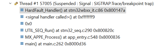

I'm using STM32WB5MMG and want to send 8-bit data through BLE every specified duration (e.g. 1s). I have tested the Bluetooth and timer interrupt separately and both works fine. However, when I tried to trigger the Bluetooth using timer interrupt as shown in the following code, both stop working.
The error is:

>>send data through BLE every specified duration (e.g. 1s)
Youre talking about BLE characteristic notification.
How long is your data?
2023-02-12 1:51 AM
The data is 8-bit. I have tested the Bluetooth separately and it is able to send data successfully. The problem is when I tried to use timer interrupt to trigger the Bluetooth. Or is there other methods to send the data every specified second without using timer?
