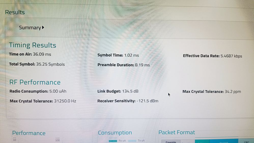

2023-10-12 8:28 AM
Hello@sergug
As of calculator I'll get 5.4kbps and that's around 324000 bits per minute .
And this no. Of bits per second will do the work.
But how can I manage atleast that speed of 5.4kbps.
I have attached a picture of calculation.
2023-10-12 8:29 AM
I'm getting 28 frames per minute.
Each frame of 16 bytes, that's around 1792 bits per minute.
