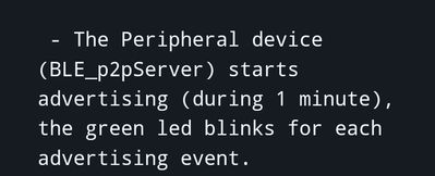

You can use different way to now if your BLE is advertising or not. For exemple in this application , a green led blink when advertising (take a look at the readme.txt file).
