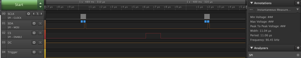

OK, I've changed my System Clock Mux to PLLCLK, and now my SPI Clock is where I expect it to be. However, I see that my interval between transmitted bytes is 11us. How can I shorten that timing? 0693W000000Vy3vQAC.png
Send larger blocks, use DMA?

It does not need CS for every byte. I'm sending data to the ST7789V TFT driver. Thats clearly something I need to look into, but I don't think that should be making the period between bytes so long. Right now I am sending data this way:
 * @brief Write data to ST7789 controller
 * @param buff -> pointer of data buffer
 * @param buff_size -> size of the data buffer
 * @return none
void ST7789_WriteData(uint8_t *buff, size_t buff_size)
	ST7789_Select();
	ST7789_DC_Set();
	// split data in small chunks because HAL can't send more than 64K at once
	while (buff_size > 0) {
		unsigned short chunk_size = buff_size > 65535 ? 65535 : buff_size;
		HAL_SPI_Transmit(&ST7789_SPI_PORT, buff, chunk_size, HAL_MAX_DELAY);
		buff += chunk_size;
		buff_size -= chunk_size;
	ST7789_UnSelect();
 EDIT: I switched to using the default pins and software enabled NSS, and that trimmed about 2 us off the period, but I'm still dealing with a 9 us period between transmits. The NSS line is switching automatically between transmits, and I don't think that adequately explains the delay.

Just a quick follow up here. I checked the timings on the HAL_SPI_Transmit() function, and it appears most of the overhead comes from the HAL function pre and post checking. There's at least 2us burned from the time you enter the function until the first bit is transmitted. I'm going to try a Low Layer SPI implementation and see what that improves.
