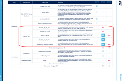

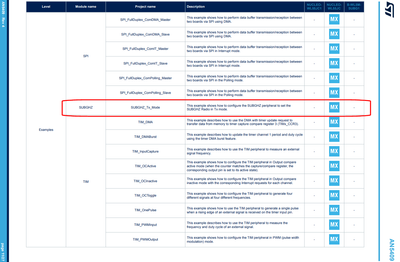

https://www.st.com/resource/en/application_note/an5409-stm32cube-mcu-package-examples-for-stm32wl-series-stmicroelectronics.pdf
