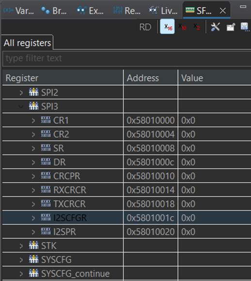

I have five identical development boards that I am attempting to bring up. One of the boards works without issues. The other four all fail during MX_LoRaWAN_Init(), After digging a little deeper I found that the SubGhzSPI peripheral is never getting enabled.
For non-working boards:
After calling MX_SUBGHZ_Init() all of SPI3/SubGhzSPI registers show 0x0 and I unable to change the values by writing to them.

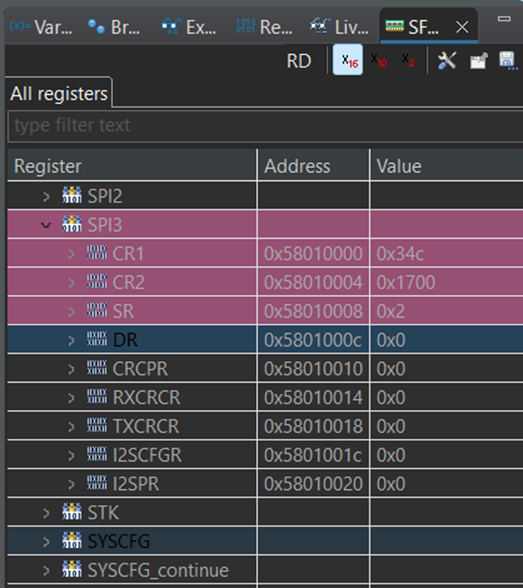

0693W00000Y7A7qQAF.pngAnd this is what I see with identical firmware on the working board after MX_SUBGHZ_Init():
0693W00000Y7A7vQAF.pngAll of the other peripherals seem to be working correctly (I2C, ADC, SPI) but I cannot configure or enabled the SubGhzSPI (SPI3). I noticed the SubGhz SPI is the only peripheral on APB3. Is there any way to reset, reconfigure or test APB3?

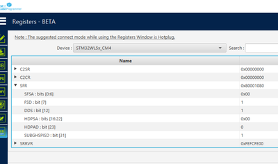

For other people finding this later, I've managed to resolve the issue on some boards by ensuring the SUBGHSPISD bit is SET in the option bytes to disable security on SPI3.

Thanks for the post, I would have not come across this solution otherwise.  I'm working with the stm32wle5 and have a board exhibiting this exact issue.  This option byte (bit?) SUBGHSPISD is not documented nor normally accessible when device is viewed as a wle5.  However I found a way using STM32CubeProgrammer and register access mode to view the device as a wl5x and the bit shows up in the FLASH SFR register.  Setting this bit to 1 will grant access to SPI3 and the LoRa radio works again.
As to why this happens...  I have a bootloader that is checking and setting RDP Level 1 using the standard HAL_Flash option byte APIs.  I'm wondering if this is related (only one board out of a few using this bootloader experienced this issue so far).

Hey, I can confirm that @firmwareguru 's approach is fixing our bricked STM32WLE5 modules with a blocked SPI towards the Radio.
So first and foremost: BIG THANKS for sharing the info how to revive the WLE5 SoC's!
I can add a few details we collected/checked after reading that post, since we had a couple "bricked ones" and coud "repair" each one of them:
In flash readback with segger j-flash (using "mem <start address> <amount of bytes to be read>" command) and reading more bytes than documented (we used J-Link> "mem 0x1FFF7800 128" in segger command line tool) for option bytes of the stm32wle5) in memory row indexed 0x1FFF 7870 the Bit 31 of this row (which is "SUBGHSPISD" as per STM32WL5x documentation and not used as per STM32WLE5 documentation) can be seen '1' if the module works, and can be seen '0' if it is bricked on the STM32WLE5 SoC/module.
Here a readback from the bricked module: JensR_1-1689076342453.png, the red marked area on a working module is 0x80 (i.e. bit 31 w.r.t 0x1FFF7870 as base address is '1')
