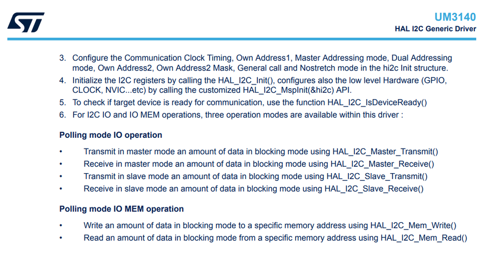

@Emil Damkjaer PETERSEN @Loic CHOSSAT this is particularly poorly described in the HAL documentation:
I really don't think it's at all clear from this description that "MEM" is the one to use in this application?
Please can we have a clear description like @TDK's in the HAL manuals - this kind of question comes up frequently on the forum!
I suspect that most applications where HAL_I2C_Mem_Read is the correct choice are not actually "memory" devices - as is the case here.
2025-12-18 9:34 AM
I think the HAL_I2C_Mem_Read naming is appropriate. Most uses of this are for actual memory addresses or register analogs. For example, accelerometers and other sensors, EEPROMs, LCD character displays. Just my opinion.
