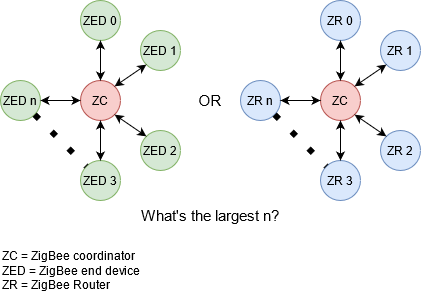

Hey, I appreciate the response and document reference but that doesn't quite address my question. In that network there's 1 coordinator and 35 routers. The situation I'm referring to is: given a single coordinator (acting also as a router) what's the maximum number of devices of a single type (whether it's end devices or router devices) that can be connected to it? I'll attach an image of the possible networks:
