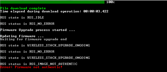

Hi, i slightly modified it and got it working without sensor board at EVK. Now i am trying to get it working at my custom board and i have an issues during co processor FW update.
When i am flashing FUS and FW file i am getting an error:
I am trying to make the same at EVK - (evk has FUS version 1.02) - FUS file was updated with same error, but when updating FW - no error at EVK.
My custom board MCU has FUS version 0.503 . and i am getting the errors both for FUS and for FW,
Any ideas?
Thanks
2019-10-04 3:22 PM
I found how to fix it, now both boards works OK :)
