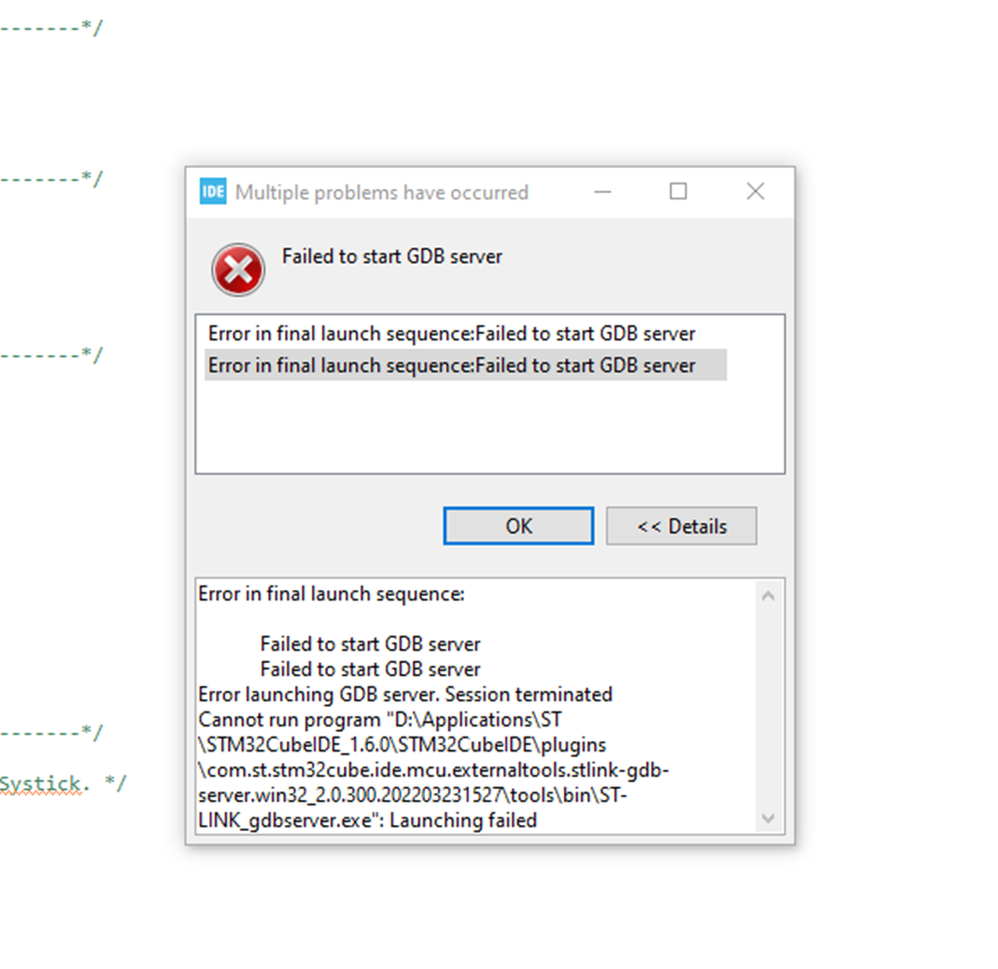

after watching a youtube video I decided to give the STM32CubeProgrammer a try....By default it wanted to load onto my C drive which is full so I chose the D:/Application/ST/ drive which has in it STM32CubeIDE 1.10.0....During install it said it may write over things but I accepted anyway as I didn't think it would affect CubeMX. I was able to change the level back to 0 on the part BUT now CubeIDE/MX will not allow me to connect anymore to the STLINK-V3SET ...I get the following:
Can someone please tell me if I can get back to using the IDE somehow without uninstalling and re-installing???

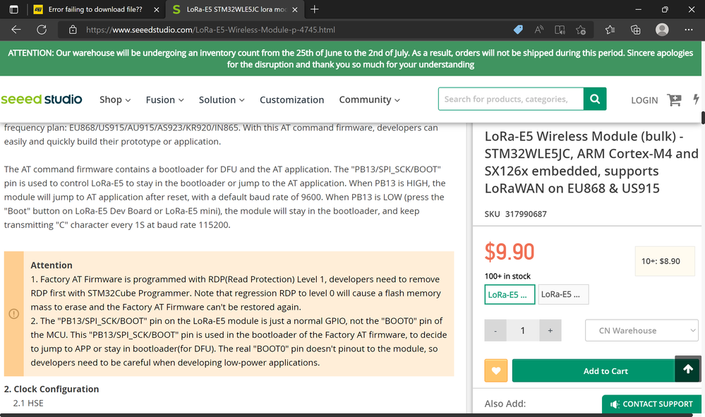

2022-07-01 11:22 AM
Removing RDP warning on image. If you dont like CLI you need install gui Cubeprogrammer.
But why waste time and space for one CLI cmd?
Locate folder in CubeIDE with STM32_Programmer_CLI.exe ... use it
2022-07-01 11:24 AM
Please see above as between you pushing this up I installed the prgrammer and now have a differetn issue????

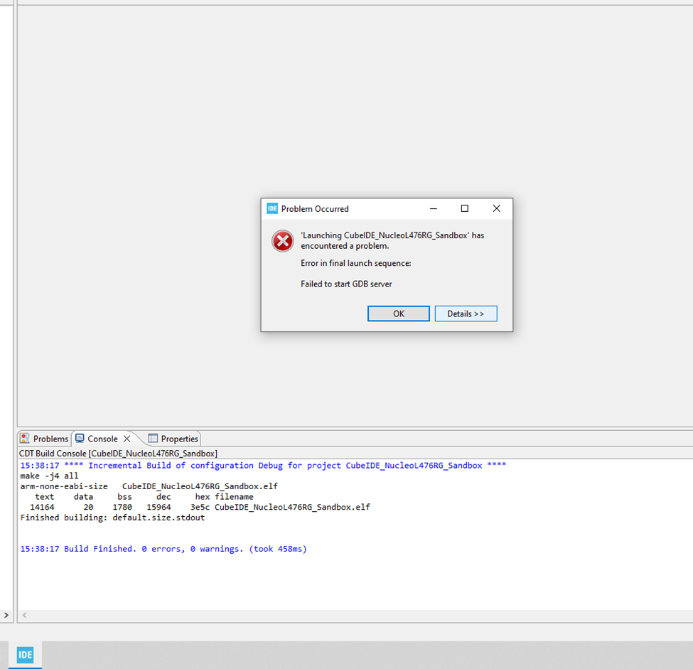

2022-07-01 11:31 AM
Try recreate launch ... delete launch files in project folder and in IDE create new RUN/DEBUG config
2022-07-01 12:42 PM
I deleted all ST applications, and re-installed CubeIDE 1.10.0 and still no luck...I then did as you suggested (now I am on a Nucleo board trying it and getting the same results), that is deleted the .launch file located in the project to no avail...Then I deleted the .launch and the whole Debug folder, rebuilt and did a Run but still not working....Still getting :
2022-07-02 1:23 AM
Try locate gdb server folder and run bat or exe ... returned info maybe help you .
2022-07-02 7:01 AM
Issue solved....three things I did and not sure it wasn't a combination that solved the problem:
In any event the gdb server executable now exists on my drive and I can use the IDE to load and debug on both the Seeed target and a Nucleo
