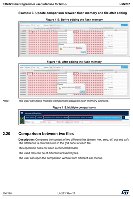

Parts of the frustration is that the documents available seems to be outdated and/or partly wrong. Just to give you some example. The release notes for the BLE Stack say that the 'full' version has to be programmed at 0x080CA000 for the 1MByte version. The UM2237 tells on page 100 the same address for FUS and BLE-Stack (latter likely wrong) and a filename for the BLE Stackfile that is outdated since 2/2020 (18months!). Additonally I got from a post in the forum that (https://community.st.com/s/global-search/0x20030030 somewhere in the middle) that reading the FUS version will not work if the SWD is used for the connection. So if this is the case, why is this pushbutton available in the SWD version of the STM32Programmer (Beside that I don't understand the technical background)?

Are you using an outdated UM? The current one doesn't have any hits for "0x080CA000" and page 100 certainly doesn't show it anywhere.
Section "2.7.1 FUS/stack upgrade" outlines how to update the stack. Seems *** proof. No chip here to test myself.
