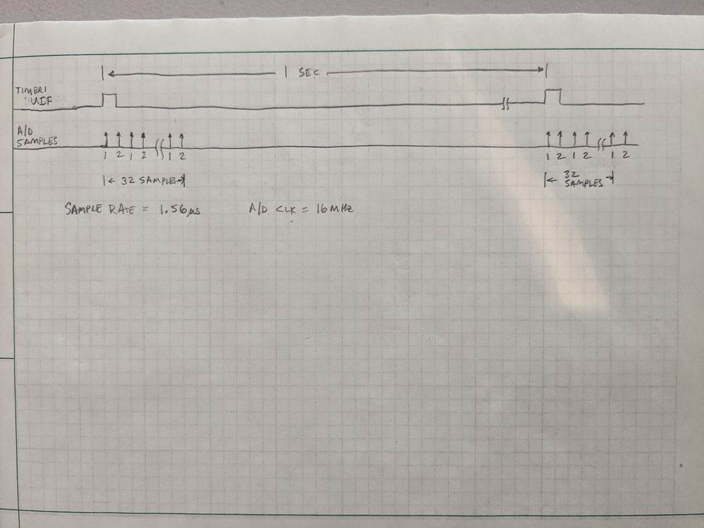

Hello....
I am trying to do a DMA of 32 samples every second. The A/D sequence is CH1, CH2. (so 16 samples of each). I have attached a picture trying to depict what I am doing. I am starting the DMA but I never get into the Transfer Complete interrupt. The TCIE and EN bit are set as seen in the debugger. Addresses all look correct and the transfer size looks correct (0x20). My timer is going off as expected every 1 second so trigger is there. I have attached MX settings for the A/D converter. Can someone point me as to what I seem to be doing wrong?
Thank you.

So I did per the above request but to no avail....I have included scope picture along with code along with setup in MX with respect to Timer1 and A/D....DMA is set up as circular buffer, periph to memory. The scope shows the GPIO that powers ch1 temperature sensors VCC pin.
Based on values in MX (A/D clock at 32MHz with a prescaler of 2) I would expect both channels to take about 1.56us for sample and hold. If we do this 32x ie 16 for ch1 and 16 for ch2, I would expect the GPIO to be high for about 5us total. The first pulse on the scope pic is about 50us wide and then one second later you can see the GPIO is now 1 second wide. Can someone please tell me what I am doing wrong here?? My initial dwg shows what I would like to do.
CODE: This is pretty simple....I turn on compare output one 3ms before the update event rollover. (I used the LD1 pin to test that every 1 second I have a 3ms pulse so I believe timer is working fine) At this interrupt I turn on power to the sensors. The update event then occurs and I collect my 32 samples....The ultimate question is why isn't the power on (blue scope trace) 5us every one second??
