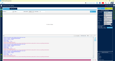

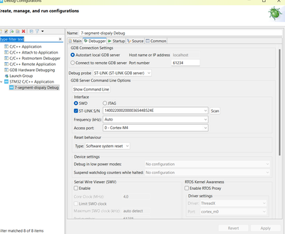

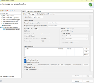

but while debugging we are getting below error please suggest solution.
IDE Configuration:

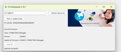

I tied BOOT0 to GND and upgraded the ST-LINK/V2 to V2J46S7 (see screenshot).
However, CubeProgrammer still fails to read the target:
